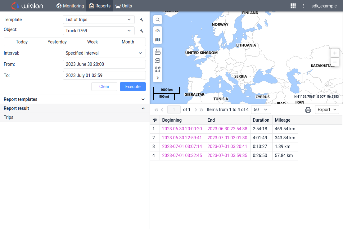

Working with a Report without Grouping
Let’s imagine, it we need to obtain the results of the the report List of trips, available to the user authorized by a token, for the unit Truck 0769 (system ID 55555) for the time interval from 2023 June 30 20:00 to 2023 July 01 03:59 (GMT+0) and export it to a PDF file using API requests.
In the web interface, the result looks as follows:

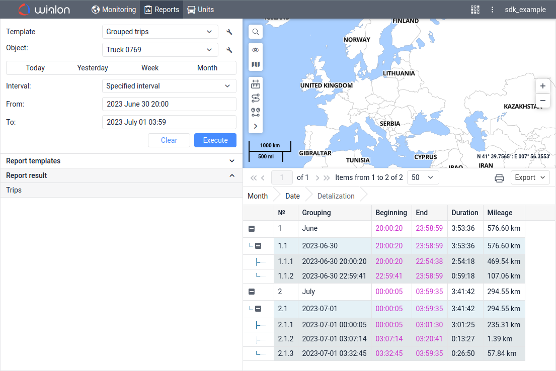

Now we need to obtain the results of the report Grouped trips, available to the user authorized by a token, for the unit Truck 0769 (system ID 55555) for the time interval from 2023 June 30 20:00 to 2023 July 01 03:59 (GMT+0) and export it to a PDF file using API requests.
Based on the result in the web interface, you can see that the Trips table has grouping by months and dates, meaning the report has 3 levels of nesting:
  • The first level contains rows with months.
    The second level contains rows with dates within the month.
  • The third level contains rows with trips within the date.

    "reportResult":{
        "msgsRendered":0,
        "stats":[],
        "tables":[
                "name":"unit_trips",
                "label":"Trips",
                "grouping":{
                    "nested":{
                        "type":"day"
                    "type":"month"
                "flags":4491,
                "rows":2,
                "level":3,
                "columns":6,
                "header":[
                    "Grouping",
                    "Beginning",
                    "End",
                    "Duration",
                    "Mileage"
                "header_type":[
                    "time_begin",
                    "time_end",
                    "duration",
                    "mileage"
        "attachments":[]
Three key parameters from the response that are important for us here are as follows:
  • tables — shows the number of tables in the report as an array. In this case, only one table (Trips) is mentioned, therefore its index will be 0.
  • rows — the number of rows in the table, which is 2 in this case. Therefore, their indexes range from 0 to 1. This refers only to the rows at the top level of nesting, there may be more inside.
  • level — the number of levels of nesting, which is 3 in this case, as there is grouping in the report. Therefore, there are levels with indexes from 0 to 2 in the table.
Other parameters from the response can also be briefly listed. The columns parameter indicates the number of columns, and their names are described in the header parameter. A value of 0 for the msgsRendered parameter indicates that the report template doesn’t display tracks on the map. Empty stats and attachments parameters indicate that there are no Statistics nor attachments (e.g., charts) in the report template.
6. Selecting Rows in a Multi-Level Table
Knowing the index of the table content, let’s display it using the request report/select_result_rows.
Copied!
https://hst-api.wialon.host/wialon/ajax.html?svc=report/select_result_rows&params={"tableIndex":0,"config":{"type":"range","data":{"from":0,"to":1,"level":2}}}&sid=SESSION_IDENTIFIER
Parameter and its value Description

Response
Copied!
        "n":0,
        "i1":0,
        "i2":1188,
        "t1":1688144420,
        "t2":1688158739,
        "d":1,
        "c":[
            "1",
            "June",
                "t":"20:00:20",
