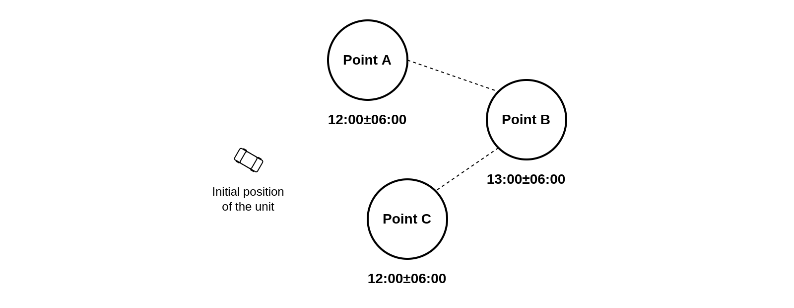

The first layer of routes consists of check points that are included in it. Check points are areas on the map that a unit must visit. They can be added using three methods:

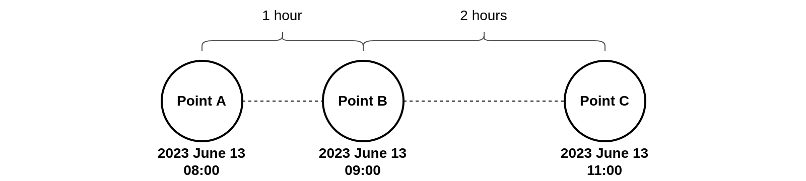

  1. Absolute — this type of schedule can only be used once, after that it should be changed, copied, or deleted.
    This type of schedule takes into account not only the time but also the specific date.

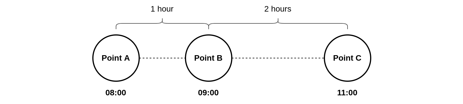

  2. Relative to day — this type of schedule can be used once a day.

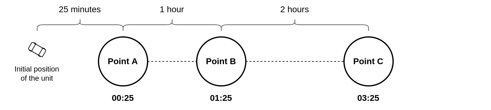

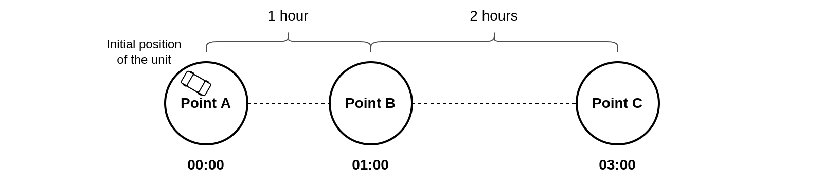

    The activation time is the time specified when creating a ride, at which the movement of the unit to the check points begins to be tracked.
    Most often, when working with this schedule, the activation time coincides with the time of visiting the first point, so the schedule lists 00:00 as the time for it, and then the time is calculated based on the time it takes to travel from the first point to the second, from the first point to the third, and so on.
    However, there can be a different situation when the ride is activated before the unit enters the first point. In this case, the schedule adjusts the time based on how long it will take for the unit to move from the activation time to the first point, from the activation time to the second point, and so on.

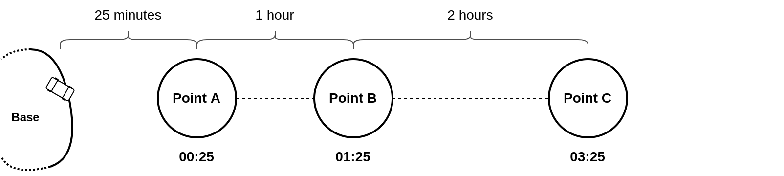

Check points order
Initially, the check points order can be specified in the schedule, but later it can be changed to another when creating a ride. The available options are listed below:
  1. Strict — all the check points must be passed in the established order without skipping.
  2. Skipping possible — the check points are expected to be visited in the established order but can be skipped, at the same time it is mandatory to visit the last check point.
  3. Arbitrary — the check points can be passed in any order.

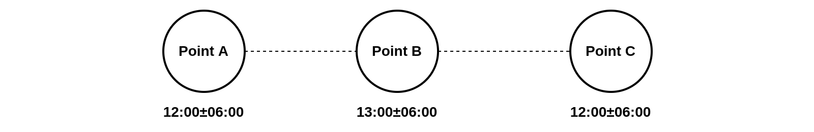

None of the schedule types prohibit entering overlapping ranges of arrival and departure times with variation taken into account. The use of this approach depends on the order of passing the check points.
For example, if the Strict or Skipping possible orders of passing points are chosen, the unit must visit them in a fixed sequence but in case of applying significant variation the visiting time can be almost any. As a result, there is control over the sequence, but not over the visiting time.
If the Arbitrary check points order is chosen, then with significant variation there is control only over the fact of visiting but not over the time and sequence.

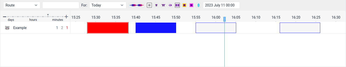

  3. The timeline also allows you to track rides in real-time. It is a special panel available at the bottom of the Routes tab. Its main feature is that units are not visible on it but the schedule is displayed in the form of ranges from Arrival to Departure (when clicking on the icon , the range will be expanded considering the allowed Variation), and the vertical line corresponds to the current time.
    Since units are not displayed on the timeline, it is not possible to determine how far they are from a check point while using the timeline. This can only be done using a map.
    If the vertical line of the current time reaches a check point, it does not mean that the unit has visited the point. The visit can only be recorded by a change in the color of the check point: before the visit, it is indicated by an empty rectangle, and after the visit, the rectangle is filled with the color of the route (in this case, blue), and if the point is missed, the rectangle is filled and outlined in red.

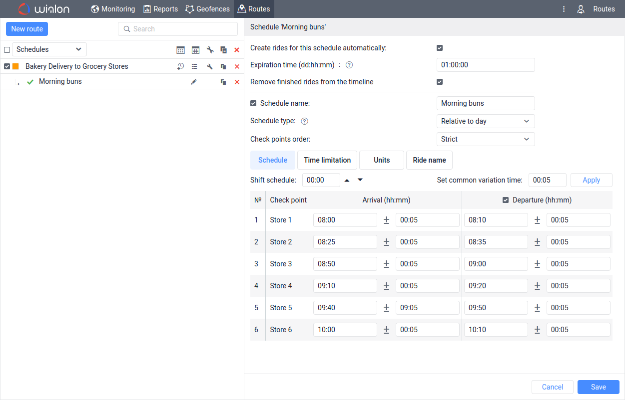

  • The ride is done once in the morning, so a relative to day schedule would be suitable.
    For each point, the Departure field will contain a time 10 minutes later than the Arrival field. The Variation field should be set to 5 minutes.
    No need to set time limitations.
  • Since the optimal order of visiting can be calculated in advance and check points can not be skipped (usually, batches of baked goods are not large and are always sold within a day), the order of visiting points will be strict.

Schedule settings

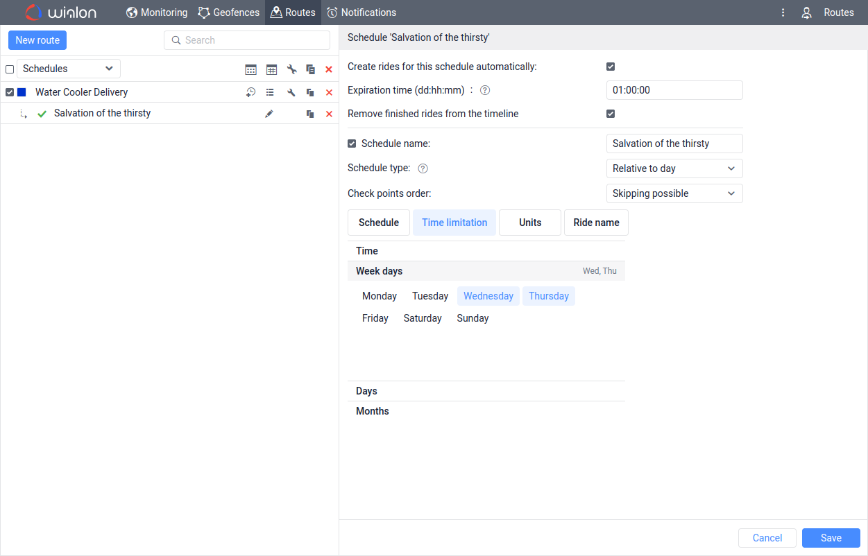

  • The ride is done once in the middle of the day, so a relative to day schedule would be suitable.

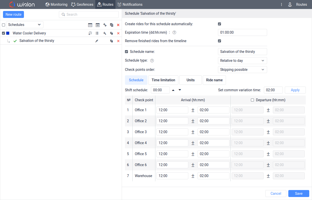

    For all check points, the Arrival field can be set to 12:00. The Departure field can be left empty. The Variation field can be set to 2 hours.
    Time limitations: only Wednesday and Thursday.
  • Since not all points need to be visited on the same day, the Skipping possible option should be selected as the order of visiting.
  • The departure time is approximately the same every day, so rides can be created automatically (relative to day).
    An additional ride on Thursday can be launched manually if necessary, but in that case, the time limitations in the schedule should only include Wednesday, so that automatic ride creation happens only on that day.
  • Customers occasionally contact the administrator to check the real-time delivery status, so notifications and a timeline can be used for tracking.
Schedule settings
Time limitations settings

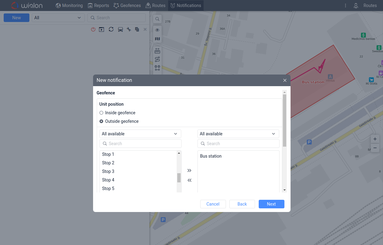

On weekends, a shuttle bus waits at the station until there is a certain number of passengers inside. After that, it starts the ride and visits each check point. The same route is performed multiple times a day.
Proposed settings:

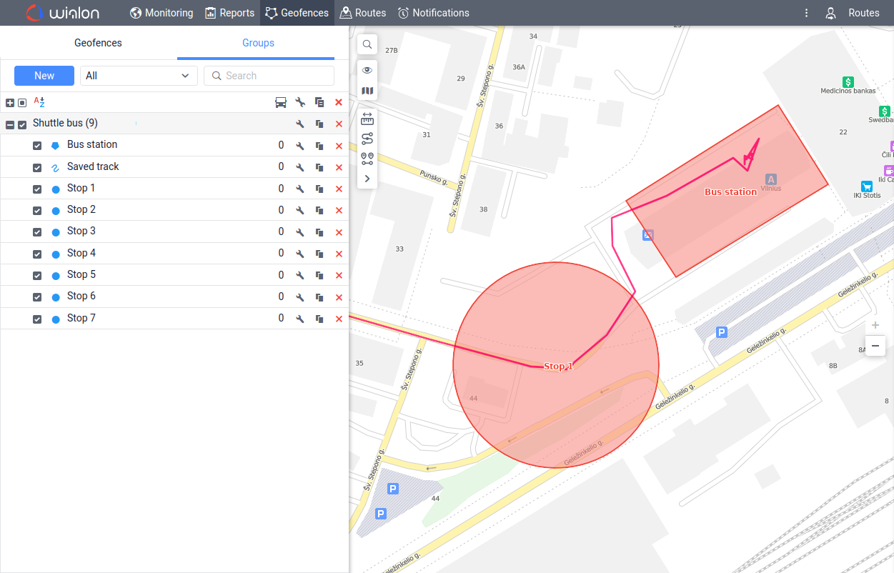

  • Check points can be added through the addresses or geofences. The passenger waiting point at the beginning of the route is enclosed by a geofence. The first check point of the route is placed immediately after this geofence.

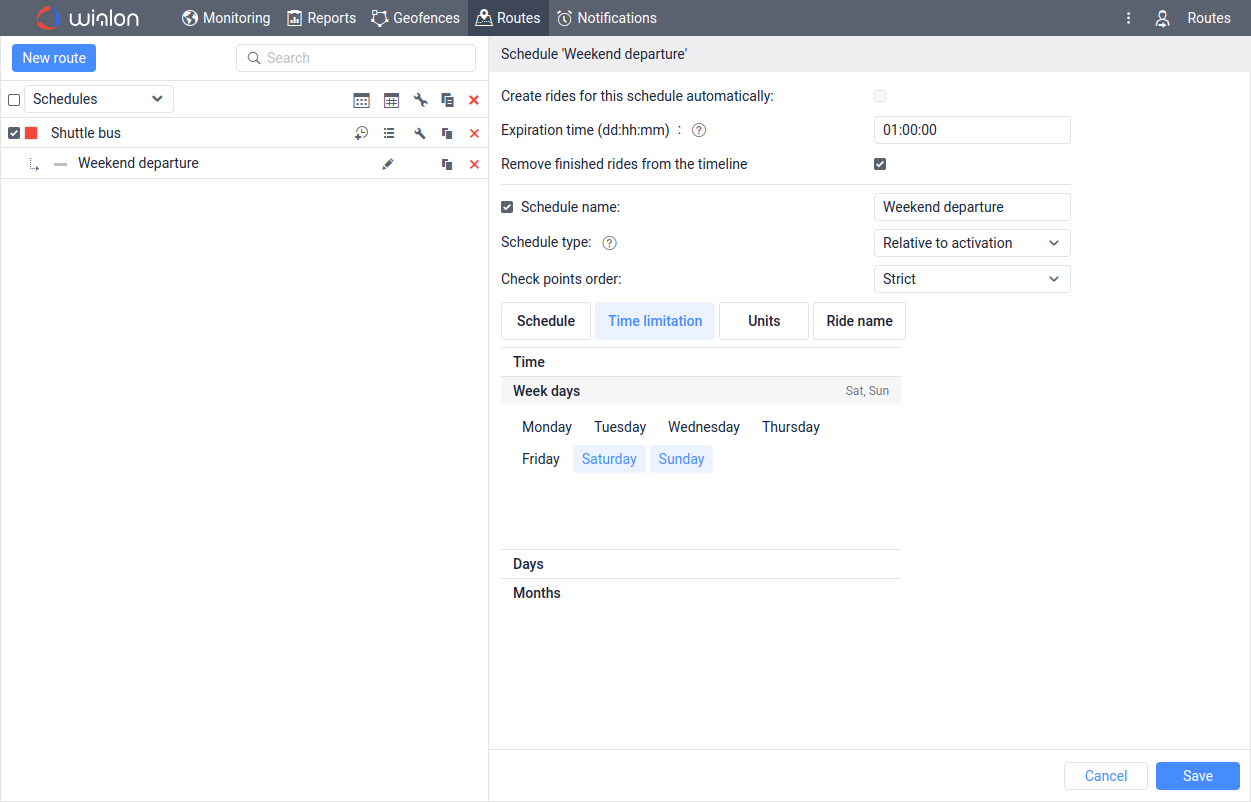

  • The ride can be done multiple times a day, so a relative to activation schedule would be suitable.
    The Arrival field for the first point is set to 00:00, and for the other points, it is filled out relative to the first point. Since the shuttle bus spends little time at each stop, the Departure field can be left empty. The Variation field can be set to any value based on the usual situation on this route (e.g. 10 minutes).
    Time limitations: Saturday and Sunday.
  • This case describes a specific public transportation route, so the order of visiting points will be strict.

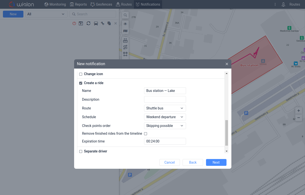

  • Since the unit starts moving only after enough people get inside, the exact start time of the ride is unknown. Rides must be created using a notification, and the criterion for starting will be leaving the geofence at the beginning of the route where the empty shuttle bus is waiting for passengers.
  • Let’s assume that during the delivery process, there are no expected real-time problems that need to be solved, so a report on a unit with a Rides table will be suitable for tracking.
Creating geofences for check points
Schedule settings
Choosing the type of notification to start a ride
Choosing the action in the notification
