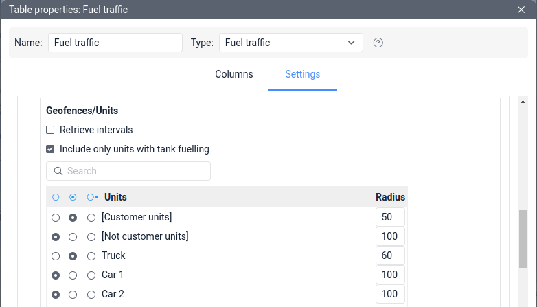

Next, the system looks for potential customers, that is, other units that were close to the refuelling truck during its fuel activities. The distance to these units is compared with the radius of approximation, which is specified in the settings of the Fuel Traffic table. Let’s assume that several such units are found.

If the Include only units with tank fuelling option is enabled in the table settings, then units without fillings will be excluded from further analysis and display. And if this option is disabled, then the report will include even those units that were simply near the refuelling truck at the time of fuel activities, but did not have fillings. Let’s suppose that the option Include only units with tank fuelling is enabled in our example.

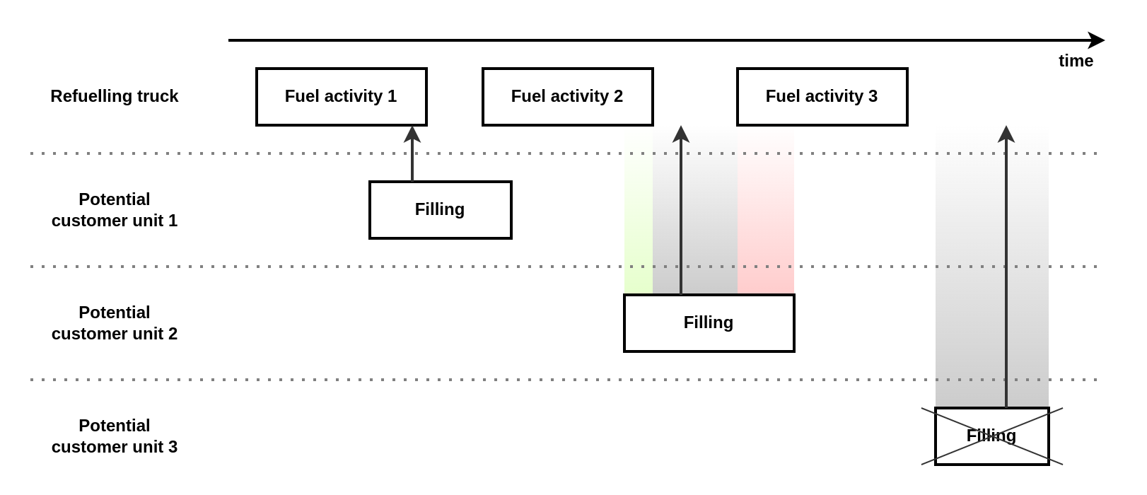

If the filling time of a potential customer falls within the fuel activity, then the filling and fuel activity are considered to be adjacent. If such a hit did not happen, then the algorithm looks for intersections of the filling interval with the interval of fuel activity. If there are several such intersections, then the filling will be adjacent to the first fuel activity in terms of time. If the filling interval does not intersects with any fuel activity, then the customer unit and its filling will not be displayed in the report.

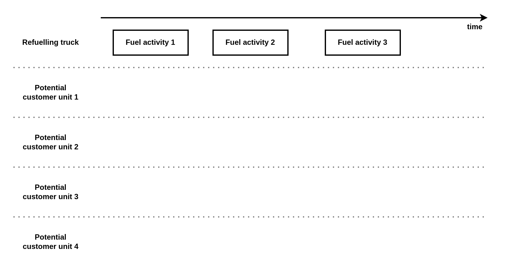

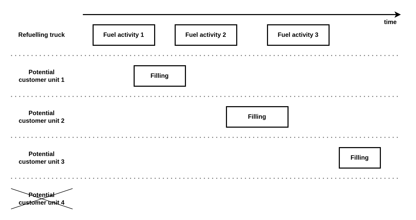

In the example shown in the pictures, we get:
  • The fuel activity 1 row will display the fuel filling of the potential customer 1. In this case, the filling time (maximum fuel level difference) of the customer unit falls within the dispensing interval.
  • The fuel activity 2 row will display the fuel filling of the potential customer 2. The time of this filling does not fall within the dispensing intervals, however, the fuel filling has intersections with several dispensing activities and will be related to the very first one.
  • No fuel fillings will be displayed in the fuel activity 3 row. The filling interval of the potential customer 3 does not overlap with any fuel dispensing.
  • The potential customer 4 will not be displayed in the report. No fuel fillings were detected for it, and according to the condition of the example, the option Include only units with tank fuelling is enabled in the table settings.

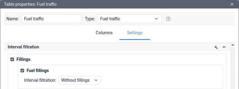

  • To hide refuelling truck fillings, open the Fillings block in the interval filtration, enable the Fuel fillings filter in it, and select the option Without fillings in the drop-down menu.

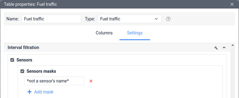

  • If the fuel dispenser does not have a fuel filling gun with flow meter installed, while other counter sensors are created for the unit, they may affect the displayed result. To hide the readings of these counters, open the Sensors block in the interval filtration, enable the Sensor masks filter in it, and specify a name that does not match the names of the counters.

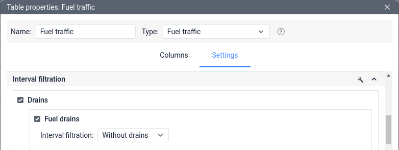

  • If a refuelling truck is equipped with a fuel filling gun with flow meter, it is recommended to work with its data and not with fuel drains detected by the FLS. To hide fuel drains from the fuel dispenser, open the Drains block in the interval filtration, enable the Fuel drains filter in it, and select the Without drains option in the drop-down menu.

You can check location-related tracker configurations or increase the radius of approximation in the settings of the Fuel Traffic table.
